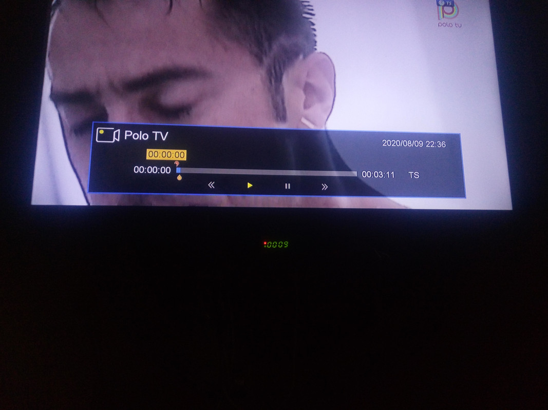

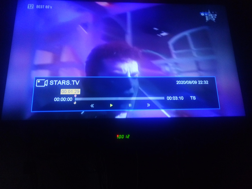

The problem with TIMESHIFT and with the recording of programs (I checked with a timer, but there is a high probability that the same problems with a simple recording)

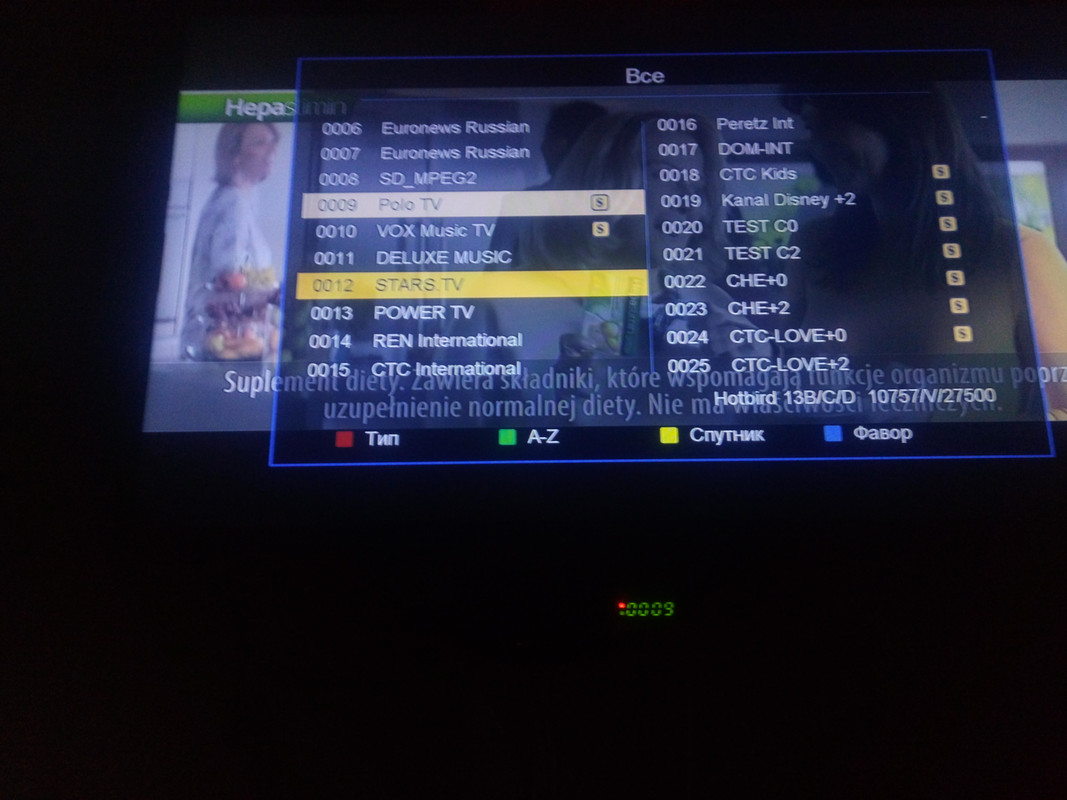

TIMESHIFT no encoded channels we are ok
TIMESHIFT with encoded channels, problems - the channel stands at 00:00:00 after clicking on play (should show with a time delay, but the encoded channel is frozen as when TIMESHIFT was started)

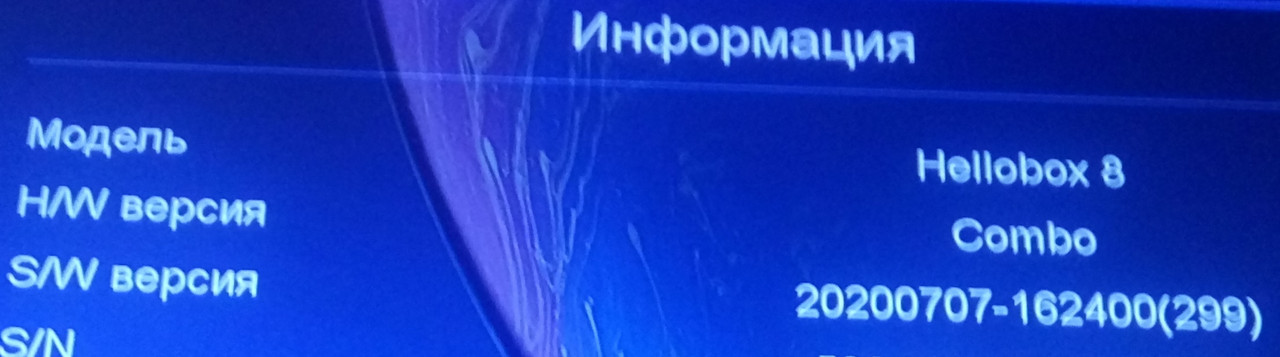

I checked Hellobox 8 NEW with the latest firmware from earlier firmwares, did not check
