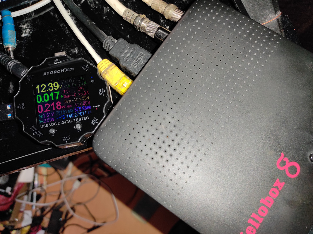

Hellobox 8 NEW in standby mode, the processor does not go into standby mode (~0.02W), but remains at full load (~0.5W)
Firmware up to 20200904
Using firmware 20200904, the standby mode works as it should(~0.02W).
From firmware 202001027A to the latest.
After updating the firmware 202001027A and up to the latest firmware 20210209A in standby mode, the processor does not go into cooling mode (~0.02W), but remains under full load (~0.5W)
My test checks.

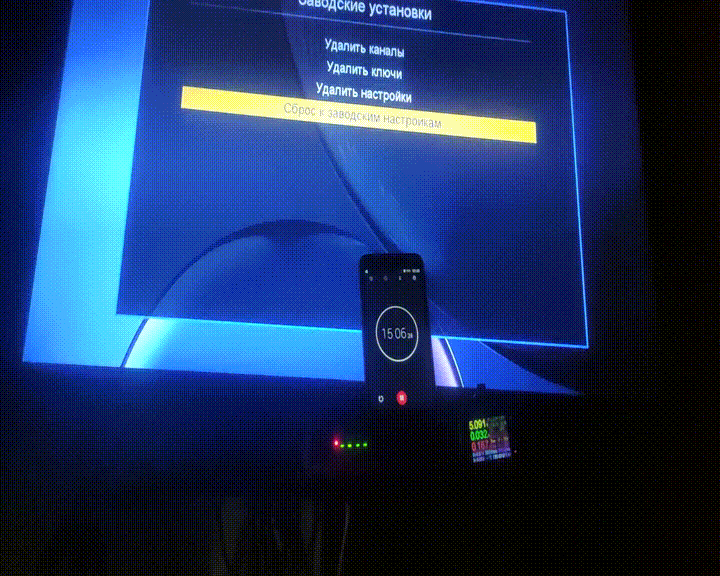

To identify the problem for what reason the processor in standby remains under full load(~0.5W):
1. After resetting all parameters to the factory settings, the absence of channels (no channels, no timers), the processor goes into standby mode (~0.02W)
2. When adding several channels, the processor switches to standby mode (~0.02W) correctly, if the timer is not configured.
3 If you add a timer, then the processor does not go into standby mode and remains under full load (~0.5W)
4. Occasionally Hellobox 8 NEW, when switching to standby mode, may freeze in the transition to standby mode as it was on firmware 20200630 (this moment can be understood when, after turning off Hellobox 8 NEW, the channel number remains on the display but does not switch to the current time, in order to restore operability it is necessary to turn from the mains).
According to tests.
It turns out that in update 202001027A and subsequent firmware
some kind of timer was added before Hellobox 8 NEW goes into standby mode, which is somehow connected with adding timers ((once, daily or weekly) and additionally noticed that the time of this timer depends on the number of channels recorded, the more channels the more time the timer has ) which does not allow Hellobox 8 NEW to go into the correct standby mode with a load (~ 0.02W) and the processor remains under full load (~ 0.5W)
The question for the programmers.
Is what kind of timer has been added since firmware 202001027A after pressing the shutdown button (switch to standby mode)?
P.S.
If necessary, I can add a screen of the board section with an electronic key, which is responsible for the standby mode. The whole problem is not in the electrical circuit, but a purely software flaw.
The background image has been replaced and the text has been tweaked to the firmware using HelloMenu GUI V1.3

According to tests.
P.S.
