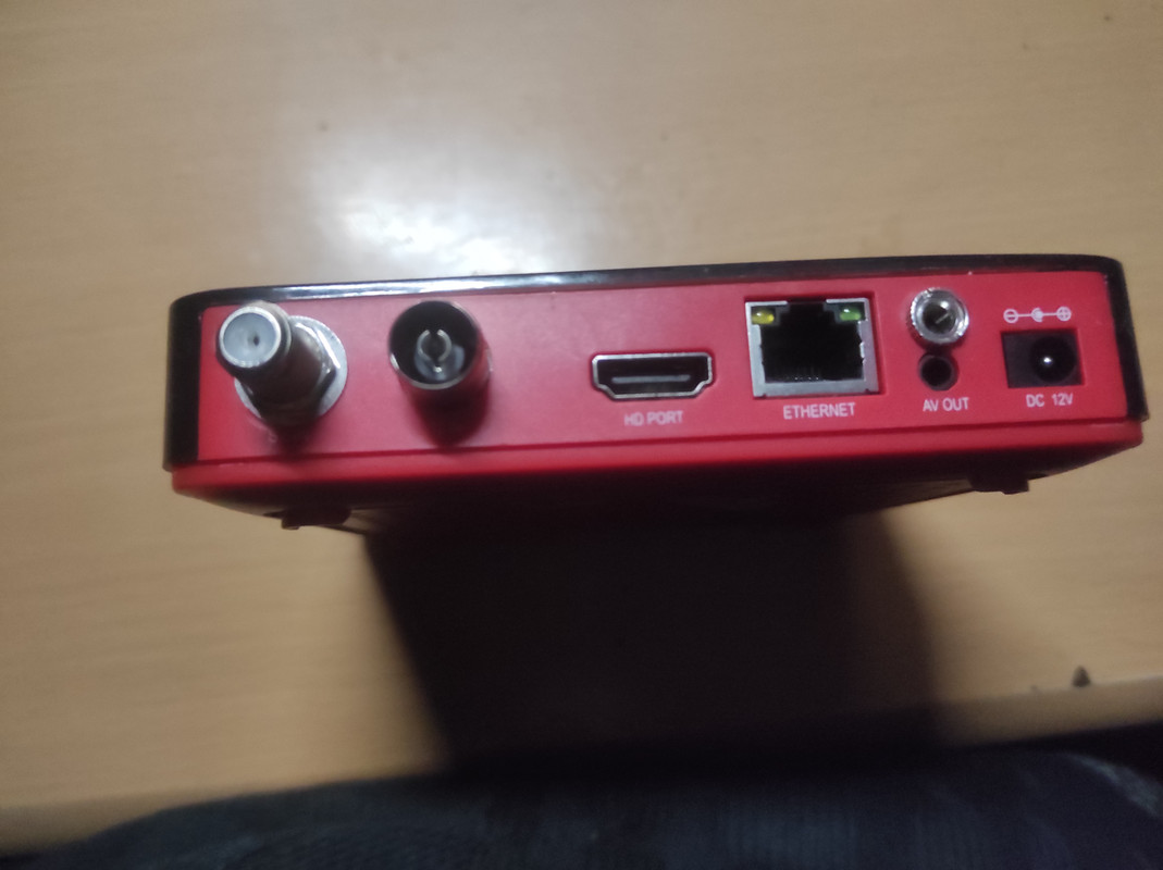

I just expressed my opinion for what this AV output is intended.Cluster.One wrote: ↑Tue Dec 15, 2020 4:22 pmYou say they did it by choice and it is not a mistake?edzus1 wrote: ↑Tue Dec 15, 2020 3:11 pmI think that the AV 3.5mm output was added in order not only to connect to modern TVs via HDMI, but also could easily connect to old analog TVs via a small plug (3.5 mm) Due to the size of Hellobox 8
Stereo sound comes from the processor, but in front of the audio amplifier, both channels are connected into one channel (mono sound)
I think that the developers just added this AV output so that it was present with Hellobox 8 and saved on a few details (this is the second channel of the sound amplifier)
If they did it by choice, did they do it to save money? and how much did they save? It seems to me a very stupid thing...
It is also true that most of the old CRT TVs are monophonic, and that few people still use them now.
But if one wanted to send the sound to a stereo amplifier, for example from an online radio, m3u. he would hear it mono ...
I have news that the cpu should be the same in the old and new version of Hellobox 8 but I can't be sure.
If you want to see a high-quality picture, you need to connect via HDMI and get a full-fledged FULL HD picture, and only get SD quality picture through AV output. But there is even a possibility to get 4K picture quality - then you need to use a network connection via Android or OIS of the DVB Player application with a device that supports 4K format or with the help of a computer and DVBPlayer or VLC Player applications.
About the fact that they were developed with savings on the second audio channel. For one Hellobox 8, it may save $ 1-2 during production, it seems a little, but it is necessary to calculate that for the production of several thousand Hellobox 8, the amount will grow large.

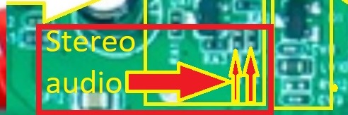

I upgraded my box and my Hellobox 8 has a stereo output for stereo headphones. I connected a ready-made board to these points that I ordered on Aliexpress with a power supply of 5 volts.
