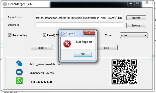

josetoni
Joined: Tue Feb 02, 2021 3:48 pm
Re: Release of Hellobox GX6605S ROM New version & HelloMerger V1.3
Post by josetoni » Tue Feb 02, 2021 10:17 pm
please help me.
I tryed to use your software but I could not because I recive the message not support
not support.jpg (65.95 KiB) Viewed 78593 times
gx6605s_dynavision_ir_7601_0629(1).rar
(3.23 MiB) Downloaded 2315 times
Joey
Joined: Wed Dec 26, 2018 9:06 am
Post by Joey » Wed Feb 03, 2021 1:59 am
please help me.
Merge for you.
Next version will fix it,please wait.
GX6605s_20210129_merged.rar
(3.33 MiB) Downloaded 2555 times
With great power comes great responsibility!
josetoni
Post by josetoni » Wed Feb 03, 2021 2:50 pm
I wait. thanks
josetoni
Post by josetoni » Thu Feb 04, 2021 3:45 am
Thanks for the merge Joey but it does not work properly, the image freezes and does not open the audio
